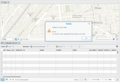

If I export as SHP and execute import,
It can be loaded into "Map" Window and become visible like usual,
but when I try to open the Attribute Table, the query stucks suddenly and pops up like this:
Opening Attribute Table from loaded SHPOpening Attribute Table from loaded SHP

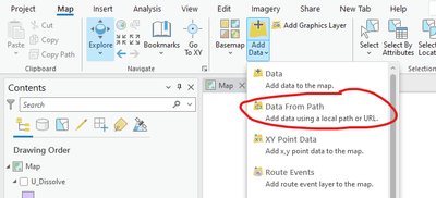

@WilliamYu811, not sure about the reason for this issue. But, here is the solution:
Open ArcGIS Pro >> Click Add Data drop-down >> Click Add Data from path >> Paste this URL :https://sidewalk.cpami.gov.tw/arcgis/rest/services/DynamicLayer/MapServer
Click OK.
The data will be added to the map.
If you want to export data from ArcGIS Pro, you can use "Export Features" gp tool: https://pro.arcgis.com/en/pro-app/latest/tool-reference/conversion/export-features.htm

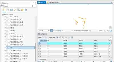

GeeteshSingh07
@WilliamYu811 , I was able to successfully add data using above workflow I mentioned:

Brian_Wilson
Honored Contributor
If you can open the spatial part of a shapefile but not the attributes then you have somehow separated out the *.shp file from the *.dbf.  You have to keep all the shapefile parts together in the same folder.
