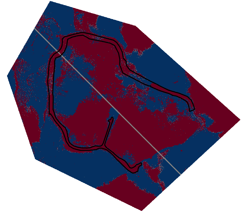

hey, i used the tool cut fill to calculate the volume between two rasters.
in the attribute table i see a volume data for each line .
first, i want to calculate the fill volumes inside the Black polygon i drew.
than, i want to summerize all the fill volumes lines .
how can i do that?
img is attached.
thanks for the help.
Extract by Polygon (Spatial Analyst)—ArcGIS Pro | Documentation
if it is truly a polygon and not a polyline
