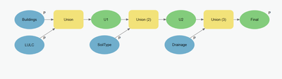

You could manage that by executing a series of Union in a Model Builder, and save it as a tool/ script.
FC1+FC2=U1
U1+FC3=U2
U2+FC4=U3
You could keep all the FC inputs as Parameter, in case you want the users to define the inputs in the tool.

That's a good idea. I don't know how to do that, but I once knew in ArcMap, so I'm sure I can figure it out again. For $3,100 a year, I might get pretty good at it.

You are the man! Thank you. I should have came here before calling ESRI lol
