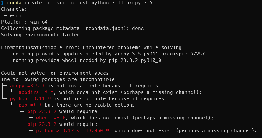

RémiBRAUN
I tried another env without any lib coming from conda-forge channel.
  • ESRI channel alone cannot solve an environment, the defaults is needed:
  • The resulting env mixing esri and main channels is still crashing, nothing to do with conda-forge 🙃
