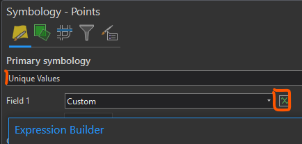

You can input that expression into the symbology as Unique Value "field":
This will give you a legend like this:

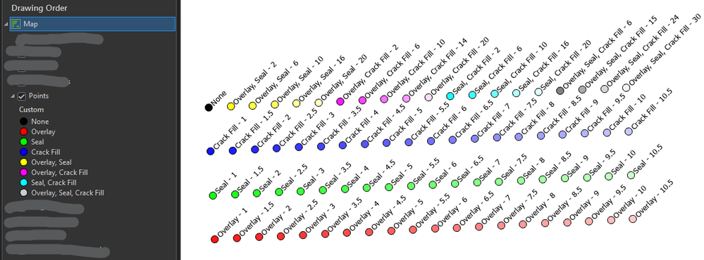

And this gives you a much more manageable legend (only 8 items) that actually provides information to your viewers:
Together with the labels:

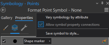

You can enable symbol property connections in the symbology, which lets you choose your color programmatically (or with a field). I didn't suggest that originally, because this isn't reflected in the legend.
But luckily, you have three treatment types which you can let correspond to the three color channels of an RGB value (red, green, blue). You can then vary the lightness of the color by using the rgb channel of the missing treatment(s). The varying lightness won't show up in the legend, so you have a manageable number of items there, and your viewers can get a sense of your point system. But they won't be able to directly get the points by looking at the color, because the color doesn't show up in the legend, so they still have to rely on labels or popups for that.
  • Overlay corresponds to the red channel, Seal corresponds  to the green channel, Crack Fill corresponds  to the blue channel.

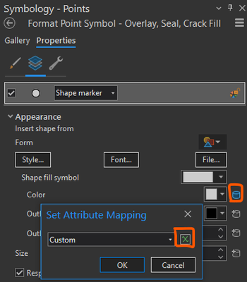

  • Use the symbology expression from my previous answer and set the colors accordingly (you have to do that manually). This is just for the legend, the actual symbol color won't be affected by this. I chose gray instead of white for all 3 treatments:
  • Allow symbol property connections
  • For each of the treatment combinations (except None), map the symbol color to the expression below.
  • The first three lines of the expression control how the color will be varied.

So it's still a little manual work, but only for 8 items, not for 65+. Here is the result:
