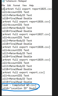

I do have a schema.ini file in the project folder never heard of this until today. I do see at the bottom the table in question and the one field I am having issues with shows up with the space. Should I delete this .ini file or remove that reference?

Edit it to remove the space. Nothing wrong with tweaking the ini file.

SUCCESS!!!
I am not the most experienced GIS Analyst, but fighting a space for almost 3.5 hours has about killed me! I have gone through all my free characters with ChatGPT. Lesson learned start with ESRI Community! Thank you both for your time!!!
