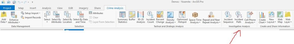

Robert_LeClair
Esri Esteemed Contributor
I'm using AGP 2.7 and the Crime Analysis tools are an option to check on Project Tab->Options->Crime Analysis->Show Crime Analysis tab.  On the Crime Analysis tab, I do see the Investigative Analysis Group in my graphic below and it shows 3 groupings of tools with a dropdown for Cell Phone Analysis.  Hope this helps!

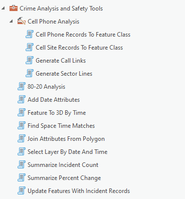

KeiranBray
Hey Robert, thanks for that, I'm on version 2020.12.17 of the crime analysis add in and I believe they've removed that tool:
and taking a look at the following, https://doc.arcgis.com/en/arcgis-solutions/reference/configure-crime-analysis.htm#ESRI_SECTION1_220F... it would appear that it is now part of "Points to Track Segments" part of the Intelligence toolbox,
I didn't realise this untill I updated to 2.7 and the older add in no longer worked for me,
Cheers
