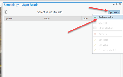

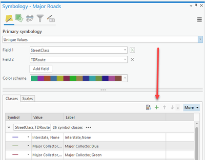

Sure, in the Symbology pane for Unique Values, you will see a plus sign:
Press that and it will let you select any combinations of the data that are NOT already in the list, OR, you can add new value combinations here:
However, I often find it easier/faster to add the 'false' data, symbolize, save, then delete the false data.
