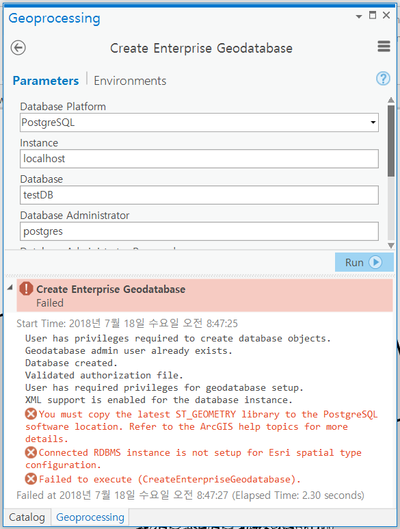

Hi,
I am trying to create geodatabase in ArcGIS Pro(v2.2) using PostgreSQL(v9.6) with PostGIS(v2.3) and getting this error.
"You must copy the latest ST_GEOMETRY library to the PostgreSQL software location. Refer to the ArcGIS help topics for more details."
I found st_geometry.dll from
  1. C:\Program Files\ArcGIS\Server\DatabaseSupport\PostgreSQL\9.6\Windows64
  2. C:\Program Files\ArcGIS\DataStore\framework\runtime\pgsql\lib
  3. C:\Program Files (x86)\ArcGIS\Desktop10.6\DatabaseSupport\PostgreSQL\9.6\Windows64
None of them worked when I copied lib to C:\Program Files\PostgreSQL\9.6\lib. I keep getting the same error.
Do I need to copy PostgreSQL client files mentioned in ArcGIS Help here.? If so, what are those files? Should I copy everything in there?

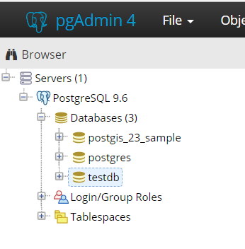

The testdb is created at least.
Any help please?
Thanks.
Min

Asrujit_SenGupta
MVP Alum
You were following the instructions for creating a geodatabase using ArcGIS Desktop. That DLL was for ArcGIS Desktop. Instead check this: Create a geodatabase in PostgreSQL on Windows—Manage geodatabases in PostgreSQL | ArcGIS Desktop
Check the "Place the st_geometry.dll file" part in the link...

MinShin
Hi Asrujit,
Thanks for your reply. I downloaded "ArcGIS Pro Database Support" package from My Esri. Indeed, the "latest" ST_Geometry library fixed the issue.
