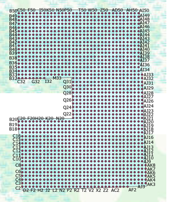

I do assume that the polygon that I'm working with is the last feature in the feature class, so actually getting the polygon shape attribute could be re-worked. I also assume that the spatial reference of this feature works in meters and not decimal degrees. And then the output feature was already created and only had a label field. This is what the output looks like though:
One thing I noticed though was that the first row and column were cut off by disjoint. So if you wanted to make sure that those were kept, you could add an initial displacement to the XMin / YMin values (eg. x = ext.XMin + 10).

And this is the result:
