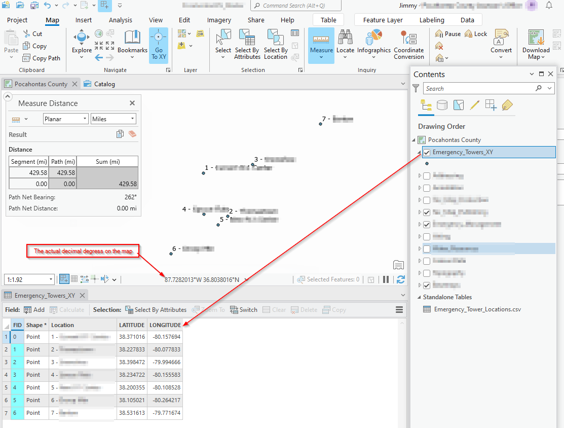

Hello All,
I am following the tutorial here to Display X/Y data from a CSV file containing the lat and long for the point's locations
https://pro.arcgis.com/en/pro-app/latest/get-started/create-points-from-a-table.htm

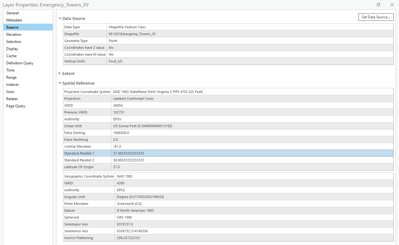

It creates a new layer with the correct lat and long in the attribute table, but the points are not appearing at the correct lat and long on the map. These coordinates should be in Pocahontas County, West Virginia, but they are putting them about 450 miles SW closer to Hopkinsville Kentucky.
The layer's projected coordinate system appears correct and matches that of my map project. Am I doing something wrong or is this a glitch in the software? I am using ArcGIS Pro 3.1.2 Standard License.
See screenshot for further explanation.
RobertBorchert
Honored Contributor
Project the points in WGS 84

JBoggs
by
New Contributor
Thanks that worked!
If you don't mind answering, what would be the reason not to use the same projection as my map project? Is decimal degrees always in WGS 84?
RobertBorchert
Honored Contributor
It is because Latitude and Longitude (decimal degrees) are by default WGS 84.  When you try to represent them in a different projection they are not able to reference the same location.  With some it may just generate the all at 0,0 out in the ocean south of Africa.
