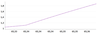

I want to create a line chart inside ArcGIS Pro, without points on nodes where there is data.
In Excel you are able to choose to display with or without points for scatter and line charts. Is there a similar option inside ArcGIS Pro?
Ingrid_Zar_1-1736861182331.pngIngrid_Zar_1-1736861182331.pngIngrid_Zar_2-1736861193886.pngIngrid_Zar_2-1736861193886.png

Hi @Ingrid_Geo ,
Thanks for the question. This is not currently possible, but in the upcoming 3.5 release, we are adding support for configuring line chart markers. This will allow you to control the marker symbol as well as the size, so it will be possible to hide the markers by setting the size to zero.
