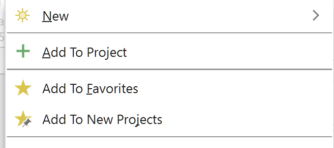

I thought I posted this but cannot find it.

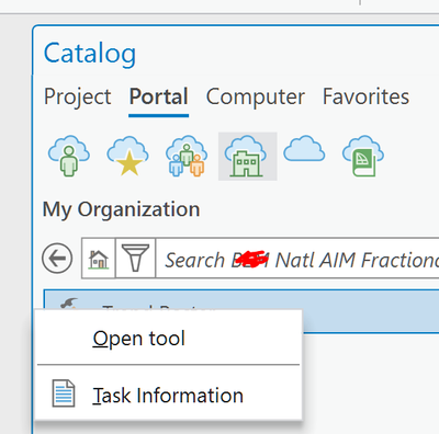

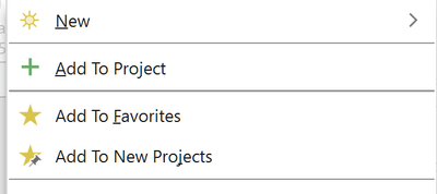

For a regular toolbox you can Right Click Favorite a regular Toolbox

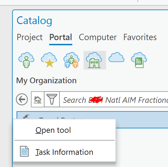

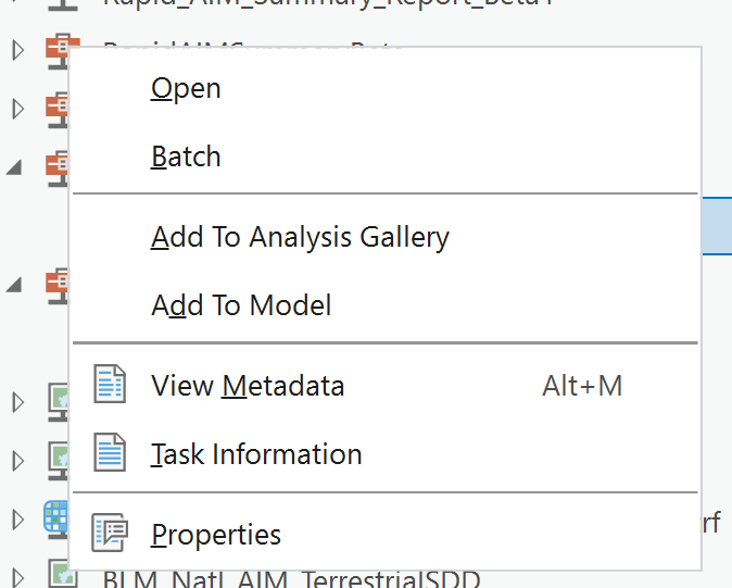

But a GP tool has no such option from both server or the Portal search
In addition you can Add to Analysis Gallery from the Server connection but not from a Portal Search.

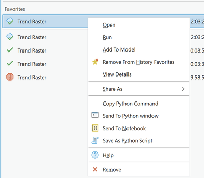

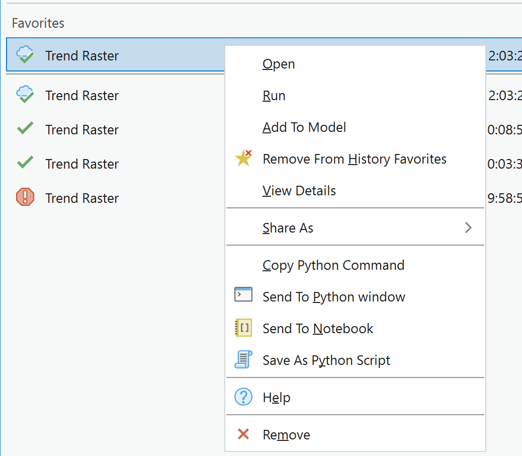

Also Add Favorite is missing from History pane for GP tools but is there for regular toolboxes.
This all seems very inconsistent.  I see no reason not to be able to Favorite from the Catalog Search.  Teaching our users to figure out adding a server connection simply to add a GP tool makes no sense.
What is weird is if I open up the AGOL item for the GP tool there is a Favorite button there that I can add it. But then the user has to also go into a browser and login. So it is possible, I think just an oversight.
Also there seems to be no way to add a GP tool from a URL in Pro?
So overall we are kinda stuck.  These GP tools are sweet but the user has to search for them every time now with no way to Favorite.
