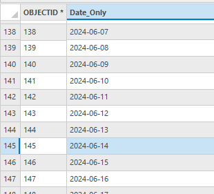

One idea to consider is there are new Field Data Types introduced at ArcGIS Pro 3.2 - one of which is DATE only.  You could create a new field using this new field type, calculate the new DATE field from the old date field, then use the code to filter out date information without worrying about the time component.
RileyScanlan

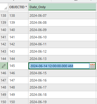

Thanks for your response! I did do that, but I notice if I double click the field in the attribute table, it shows a timestamp of 12:00. Not sure how to prevent that?
Robert_LeClair
Esri Esteemed Contributor
Yes.  So I believe you're not using the correct field type.  In the Fields Designer, you need to select the "Date Only" field type rather than the "Date" field type.  I was able to replicate the behavior you're seeing using the Date field type.  If I use the "Date Only" field type, then I do not get the 12:00 AM timestamp.
RileyScanlan
Okay yes was able to create a new Date Only field and transfer the info over, thank you! Though I am creating a local version of the grid layer because it is a hosted feature class used in several field maps. In the past I've had issues adding fields to a hosted layer from ArcGIS Pro.
