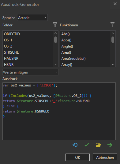

PatrickLösel
Hello Johannes,
thanks for the fast respond! I now tried the following expression, but it still didn't work.
JohannesLindner
MVP Alum
The second argument of Includes() has to be a single value, you're trying to input an array.
https://developers.arcgis.com/arcade/function-reference/array_functions/#includes
Have a great day!
Johannes
