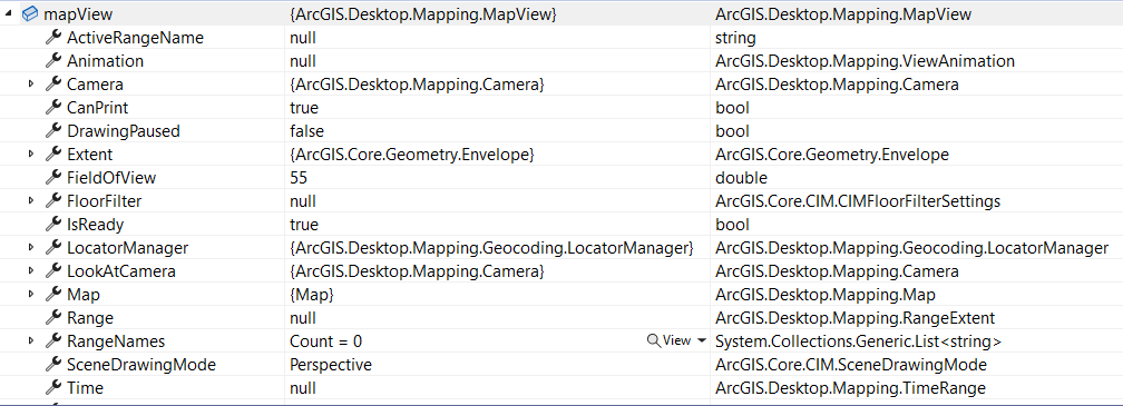

 This code works and I can see properties of the mapView if I set a breakpoint.

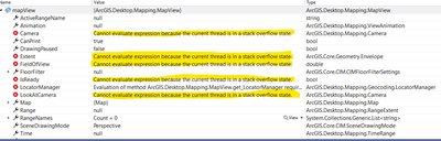

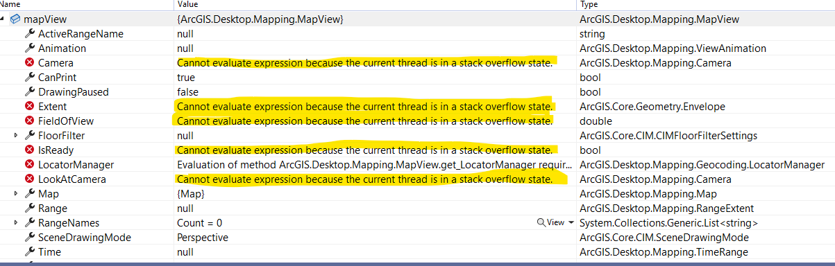

 But if I put a breakpoint within the QueuedTask.Run body I get a stack overflow error when trying to view most object properties
So the code works but I cant see any properties while debugging. I have no idea what is causing this and hence I can't actually write my plugin.
Cannot evaluate expression because the current thread is in a stack overflow state.
