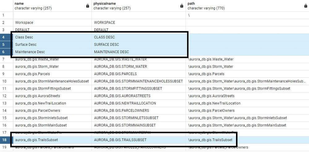

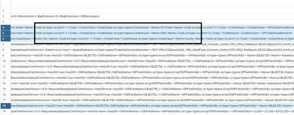

I'm using ArcGIS Pro 3.4.2 and a PostgreSQL relational database.  I have a trails feature class with subtypes and domains. In Postgres's equivalent of SSMS, pgadmin, if I go into the gdb_items repository table, under the definition/xml field for the database.owner.TrailsSubset row (FC is in the name column), there's a super long XML field that you have to scroll through to find the subtype code and description.  For the domains, it's another row(s) in the same table.  My domains are called Class Desc, Surface Desc, and Maintenance Desc under the name column.  The codes and description are in the XML column for those row items.  See images below.  But with all this said, not sure how to create the DBView query to access these items...

Thank you so much for providing the example and for your help with Viewing the Location of Domains and Subtypes in pgadmin which is the same at SSMS.
i think all is good for extracting domain and creating tables for it so I can extract the code and description separately
