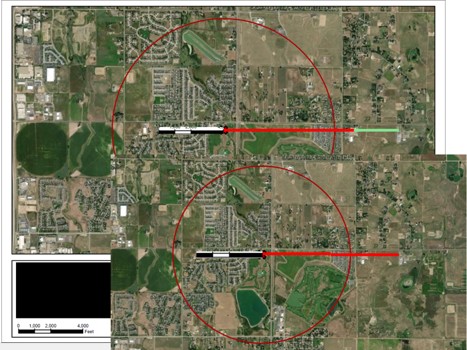

On ArcGIS Desktop (version 3.4.2), a coworker and I are generating some diagrams for a site when we came across a peculiar oddity. Despite the layout, projection, and scale being the same, the figures that are produced appear to be on entirely different scales. As you can see in the attached images, both of the scales are 1:30,000 but the zoom appears entirely different. The areas you see highlighted have 1 mile buffers and appear to be of the same size, it's just the figures have completely different zooms.
Any help would be appreciated in this issue so that we can work to remedy it.

It's just wrong really.  The scale text and bar must be linked to the other Map Frame, or the bar and text are static or graphic elements.  I would go into google maps (other map services are available..) and do a quick sanity measurement to see what might be going on.
It's very basic, but scale bar for each map is to the left of the centre marker, and 8000ft (2 x scale bars) is to the right.  Green line is difference.

I ended up figuring it out after pulling both projects in this morning. For whatever reason, when I moved one of the maps to a different coordinate system, it displayed that it had when it reality it had not. Simply refreshing the map's coordinate system so that they both actually lined up (thanks Arc 3.4!) ended up ensuring that they lined up.
I appreciate the help!
