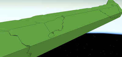

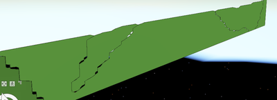

- We want to be able to view a solid cross-sectional slice of it, based on a 2D line. Below is what I managed to do eventually. The different sections represent different rock formations

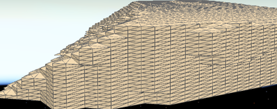

- Trying to generate a closed multipatch from the 3D polygon shapefile was not possible through a combination of "Layer 3D To Feature Class" and "Enclose 3D". It kept giving me a open multipatch (Is Closed 3D returns false)
- It turns out the 3D polygon shapefile vertices were not snapped to one another, even if it looked like it. Post-processing the raw 3D polygon files to get a closed 3D object, the vertices dropped from 800k to ~200k. I'm not sure if its a precision limitation of shapefile, just the nature of working in 3D or inaccurate raw data.

1. Import the 3D polygon shapefile into Blender using a custom add-on. (Credit to https://github.com/domlysz/BlenderGIS this solution wouldnt be possible otherwise)
2. Use Blender tools to merge all close-by vertices. This will generate a truly closed 3D model
3. Export as COLLADA .dae file. Import into ArcGIS Pro. Gives a 3D rock formation as a closed multipatch.
4. From the 2D polyline, use arcpy to create a 3D vertical slice shell around it.
5. Use Step 4 output as input to Minimum Bounding Volume. Gives a 3D vertical plane as a closed multipatch.
6. Run Intersect 3D, using Step 3 output and Step 5 output.
7. Publish to ArcGIS Enterprise

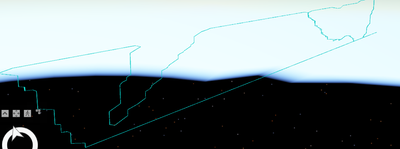

Extract Multipatch from Mesh: gives a cross-sectional slice, but it has a hollow outline instead of being solid, filled-in
