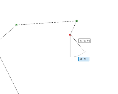

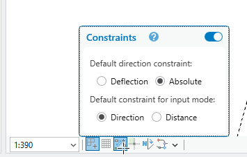

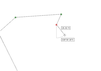

I have two ideas that might help you accomplish your desired workflow.
1. Utilize the on-screen constraints.  When on you can actually access the direction and distance display and type them in.  Once you see the constraints, click Tab and you will now be in the direction, type the value, hit enter and then type the distance and hit enter and the segment will be created (you can use a polyline too).
