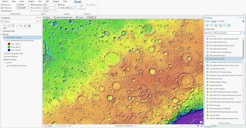

Robert_LeClair
Esri Esteemed Contributor
One option to consider is instead of downloading and processing the Mola data is to use the Portal search option in the Catalog Pane in ArcGIS Pro and add a web layer to a map view in ArcGIS Pro.  See below for an example.
