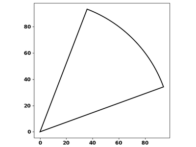

sector code
def _arc_sector(radius=100, start=0, stop=1, step=0.1, xc=0.0, yc=0.0):
    """Create an arc from a specified radius, centre and start/stop angles
    Requires:
    `radius` : number
        cirle radius from which the arc is obtained
    `start`, `stop`, `step` : numbers
        angles in degrees
    `xc`, `yc` : number
        center coordinates in projected units
    Returns:
      points on the arc
    start, stop = sorted([start, stop])
    angle = np.deg2rad(np.arange(start, stop, step))
    x_s = radius*np.cos(angle)         # X values
    y_s = radius*np.sin(angle)         # Y values
    pnts = np.c_[x_s, y_s]
    cent = np.array([xc, yc])
    pnts = pnts + cent
    sector = np.concatenate((cent[None, :], pnts, cent[None, :]), axis=0)
    return sector
example call, it returns a numpy array.
a = _arc_sector(radius=100, start=20, stop=70, step=1, xc=0.0, yc=0.0)
angle from 20 to 70 (relative to N over 0 to 360) in 1 degree steps with center xc, yc)
If you need a list
a_list = a.tolist()
