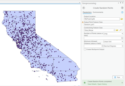

JayantaPoddar
MVP Alum
I just upgraded ArcGIS Pro to ver. 2.9.
Create Random Points works fine for me.
Did you try rebooting ArcGIS Pro, or deleting the Display cache. Test with a different layer as constraining extent.

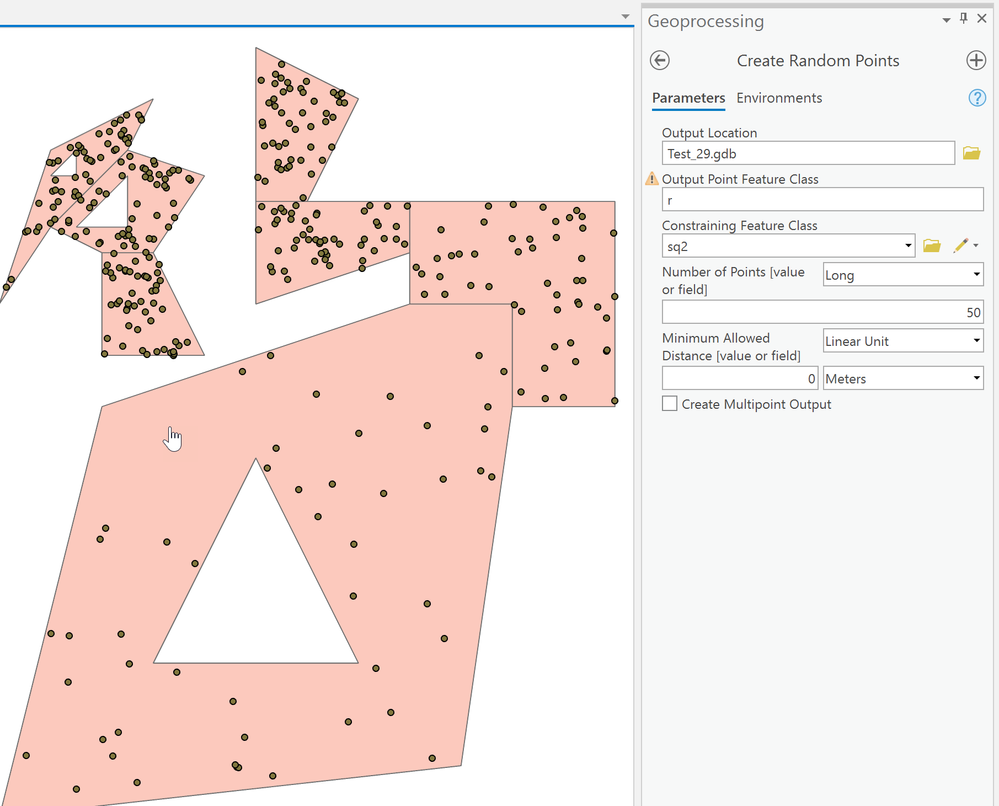

DanPatterson
MVP Esteemed Contributor
all is good

JayantaPoddar
MVP Alum

DanPatterson
all is good
