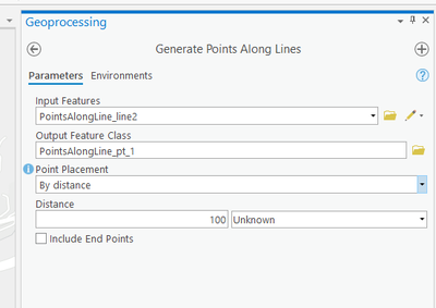

I have a line feature and want to create points along the line at specified intervals.. I can do this with the "Points Along Line" GP Tool...
BUT I need to record in a field the distance it was created at...
Example:  I have a line 100 ft and it creates 10 points along the line... I need each point to have a field like "DistanceAlongLine"  and the 10 records would have 100,200,300,400 etc in it.
Can this be done... As stated I can get  the points but dont know how to get the distance along the line to be put in a field.

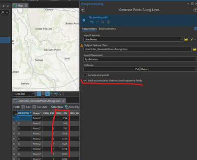

SMauri
Hello, the features you are looking for appear to be already integrated into the tool, as you can see from my image (ArcGIS Pro 3.3)
Cheers
Stefano

SMauri
Cheers
Stefano

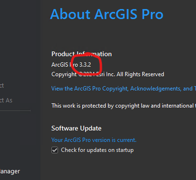

kapalczynski
What version are you on as I do not see that option
SMauri
ArcGIS Pro 3.3.2
kapalczynski
Thanks ... I upgraded and can not see that additional functionality to the GP Tool that was not in earlier version... Thanks Again

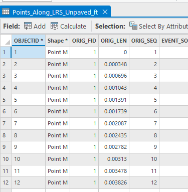

kapalczynski
wondering why my results are as such.... I specified 100ft intervals..

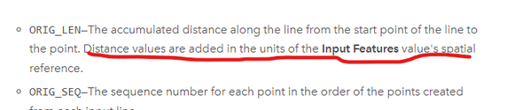

SMauri
Maybe because of this...
