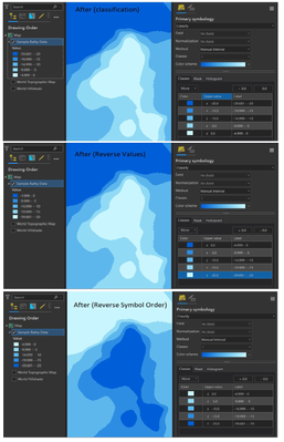

I am using ArcGIS 2.9.0 and having issue re-sorting the classified symbology for elevation layer. I am trying to flip the order of the depth ranges in legend to be listed from shallow (on top) to deeper, instead of displaying deeper to shallow. Looks like we should be able to do it by clicking on 'More' under 'Classes' tab then 1. 'Reverse values' and 2. 'Reverse symbol order'.
For some reason, when I apply 'Reverse symbol order' the symbol flips in legend/symbol list but the content in mapframe is also flipped. Same steps with same data, works without any issue in ArcGIS pro 2.8.2. I tried saving a desired layer file in ArcMap 10.8 as well as Pro 2.8.2 and import into my ArcGIS 2.9.0 but the .lyr file also shows deep (on top) to shallow depth in legend/TOC though it is displayed correctly in mapframe.

Thanks a lot for the response. I have tried all that I could think of including restarting the computer, doing in fresh ArcGIS project, exporting as layer file, but same issue. Below is a screenshot showing classified - value reversed - symbol reversed outputs.

In the first screen shot, the bathymetry (stored as negative values) are classified as five classes viz. Deeper than 20m, 15-20, 10-15, 5-10 and 0 to 5 m. Deeper values are shown with darker gradient of blue, which is what I want and I just need to flip the order the classes so that it displays 0 to 5m first and deepest value at the bottom, for the purpose of legend. Second screen shot just shows the intermediate result after applying the 'reverse values'. But when I reverse the symbol order (third screen shot) the list of classes in symbology pane and content panel look ok but the color gradients in the map is incorrect.
