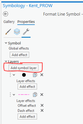

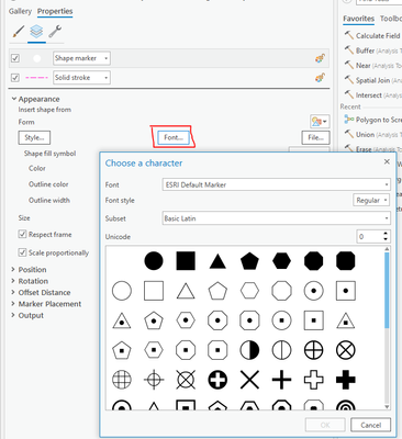

@tschawe this page should hep you. https://pro.arcgis.com/en/pro-app/latest/help/mapping/layer-properties/line-symbols.htm
But you're basically adding a "marker" symbol layer to an existing line style using the settings tab
And then updating that symbol in the layers tab.
You can add the symbol you need from an existing font character, or import an SVG file of your vector symbol.
