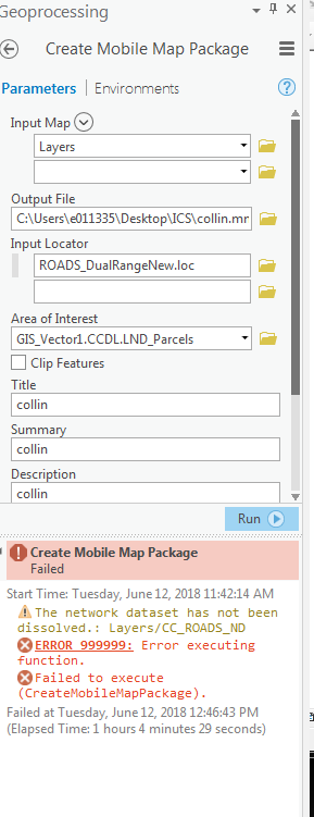

I am making an attempt to create a mobile map package in ArcGIS Pro which incorporates parcels , roads and a network dataset . I'm continuously obtaining this error once running the tool virtually at seventy two percent.
here is my parameters.

Try turning on clip features, or using a clipped subset of parcels as your area of interest.  The area of interest can just be a uncomplicated boundary shapefile, if that is appropriate to your task.  In some states, I would dissolve a statewide county outline into separate, individual county boundaries.  If you are in Texas: Political Boundaries | TNRIS - Texas Natural Resources Information System
HushamMohamed
Thank you,  Will try that and let you know.
HushamMohamed
NO Luck  still same error of the network dataset has not been dissolved.
