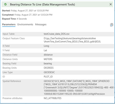

Hi Tina,
Thanks for sharing the test data. We have tested in 2.6, 2.8, and our current development versions, but could not reproduce the problem.
I noticed the OBJECTID values are not sequential. That should not matter. But you can try using Copy Rows tool to turn it to a gdb table, then run Bearing Distance To Line.  Hope that works.

Hmm, the tool worked for me...
Try constructing the lines yourself: edit the input and output parameters of this script and run it in the python window.

As suggested earlier, excel to table or table-to-table tool with the output as a file geodatabase table, then run the tool which I suggested and Dan Lee confirmed works, unless the data fields are in the wrong format or the data content needs adjusting.
