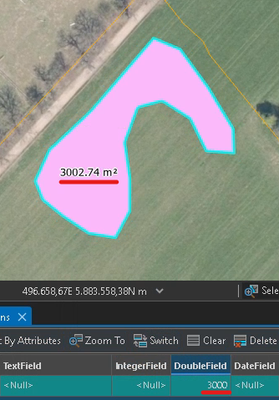

Create a new double field in you polygon feature class. This field will store the target area.
Create an Attribute Rule for your polygon feature class. Use this expression (use the new field's name in line 7!):

The workflow would be something like this:
  • create a rough outline of where you want the trees to be
  • Change the value of your target area field (DoubleField in my test data). The rule triggers and tries to get the polygon as close to the target area as possible.

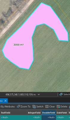

  • Delete the target area value. That hinders the rule from constantly changing you polygon in the next step.

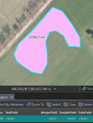

  • Use the Edit Vertices tool to iteratively change vertices until you hit your target area. Remember, the label isn't updated while you drag a vertex, so you will have to complete the edit to see the new area.
