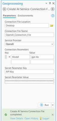

Hi @IgnacioYañez ,
I just tested the Create AI Service Connection File tool with OpenAI, and it worked correctly when I set the connection parameter as follows:
Key: Model
Value: gpt-4o
After creating the connection file this way, it was successfully recognized by the Vision Language Context-Based Classification package in ArcGIS Pro.
Hope this helps!
