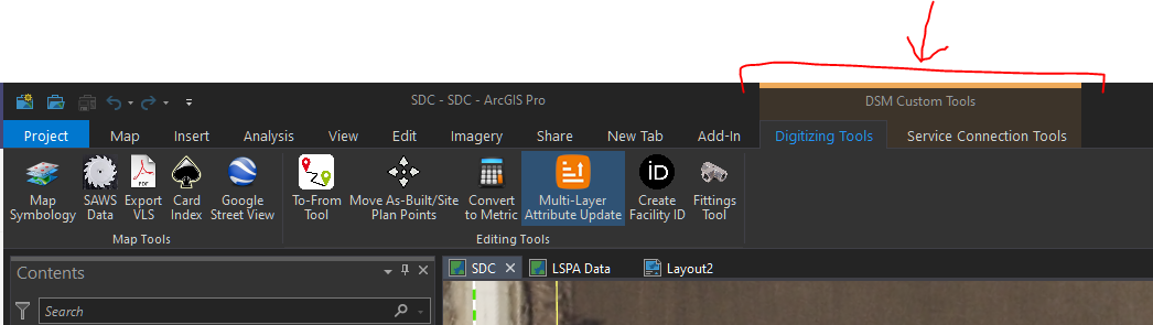

Hi,
In my config.daml I can create a Tab Group, and then create tabs and groups within, but that is all done in code.  Is it possible to do this without code just using the "Customize the Ribbon" menu?  I see that I can create a tab in an existing group, but I do not see how to create my own new group of tabs.
This is a screen shot of what I'm trying to build through the "Customize the Ribbon" menu:

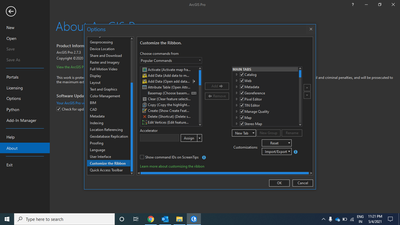

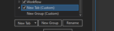

DrVSSKiran
Yes, you can. There is an option under the option settings. Please refer to the below screenshot.
Here is the outputs which you are looking for,
BrianBulla
Honored Contributor
That's not what I'm looking for.  I'm looking to create a "Tab Group"....not just a regular group.  See my screenshot in the original post.  I'm trying to see if I can recreate the visual appearance where the two tabs "Digitizing Tools" and "Service Connection Tools" are grouped together under "DSM Custom Tools".
DrVSSKiran
In that case, we need to create a plug-in or add-in with the customize coding.
