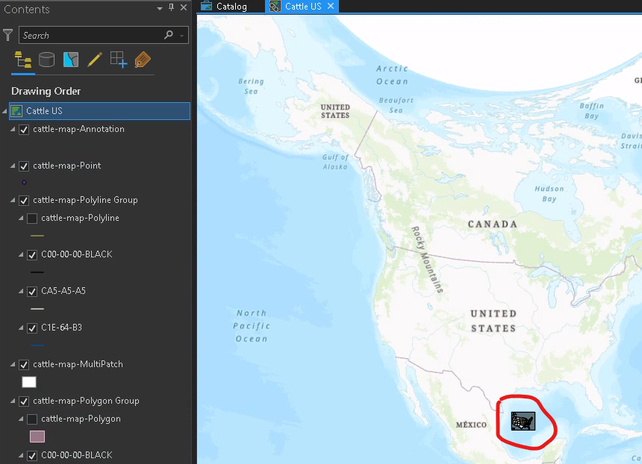

So, convert the pdf to dxf and load that file into ArcGIS Pro:
The dxf file actually contains multiple layers with the different geometry types. Sadly, the points of your map aren't actually stored as points, but as polygons. So we will have to convert them.
Also, the data doesn't have a coordinate system, so we have to do something about that.

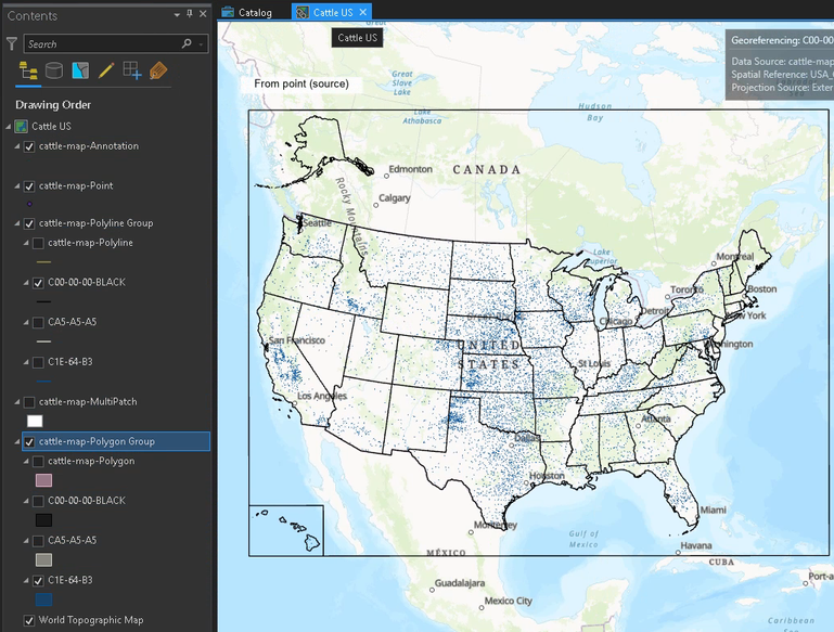

Now that we know the coordinate system, lets apply it to the map:
active_map = arcpy.mp.ArcGISProject("current").activeMap
active_map.spatialReference = arcpy.SpatialReference(text=wkt)
The coordinates in the pdf are wrong, so we need to georeference the dxw layer.
Now we can extract the polygons. There are probably good reasons for the custom projection, but it might be better to change the projection to something more widely used. I'm using WGS 84 here, which is the standard system used in GPS. We don't need to project every layer, only the "Polygon Group / C1E-64-B3" layer, which contains the points (as polygons).
arcpy.management.Project("cattle-map-Polygon Group/C1E-64-B3", "CattlePolygons", 4326)

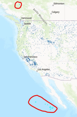

I'll attach the resulting shapefile to this post. This only includes the points for the continental USA. If you need Hawaii and Alaska, you'll have to ask for the data or do it yourself. Just start with georeferenceing the dxf to the respective state.
