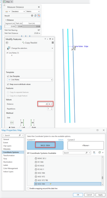

I am editing an existing feature layer and existing measurements are accurate if I select geodesic in the measurement tool.
I am using the "copy parallel" tool and want to offset by 25m, however once it is created it ends up being around 20m when I measure it using the measurement tool and selecting geodesic.
Is there a geodesic setting I should be choosing somewhere??

Scott_Harris
@EditorCarbonNet The Copy Parallel tool will create parallel lines using geodetic distances as long as the map uses a geographic coordinate system such as WGS 1984:
