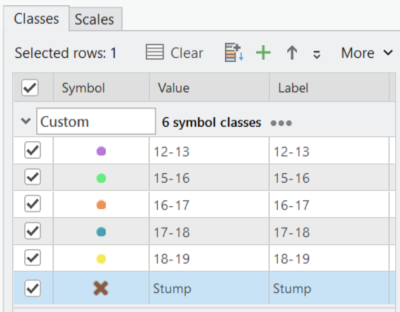

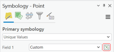

JesseWickizer
Use the Unique Values renderer but next to the Field menu, click the Expression button to use a custom Arcade expression to define your classes.
Write an expression that returns "Stump" when the Genus field value equals "Stump", and otherwise return the Planting_Season field.
if ($feature.Genus == "Stump") {
  return "Stump";
} else {
  return $feature.Planting_Season;
The Symbol classes would look like this afterwards:
