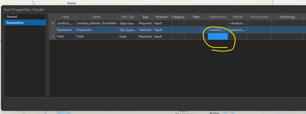

In the tool's properties, I can see this as a parameter, but the 'Dependency' option is unresponsive.

This has got me thinking because, just like you, I can not set the"dependency" up in a model - it is grayed out in the Model Properties dialog ; Parameters tab, just as you report.

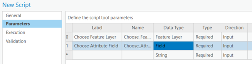

4: Create 2 parameters as shown below:
Notice the data types.
5: For the attribute field parameter scroll until you see the Dependency property.
6: Click in the Dependency property for the Attribute field parameter and select the feature layer parameter name:

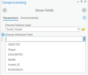

8: Double click the script tool to display the dialog. You should see 2 parameters:
9: Choose the input feature layer (or feature class) and the Choose attribute field parameter should then be populated!

Hi Ed, do you have any update on this functionality? I'm running ArcGIS Pro 3.5 and have found that I'm still not able to set up field dependencies. I've got a ton of experience with Python scripting, but for simple workflows, I prefer to use model builder because I'm building tools for a larger team and would like these simple workflows to be easily maintained by staff that aren't so familiar with scripting. It seems like this is a pretty core feature if Esri would like to offer Model Builder as a viable alternative to scripting in Python. Thanks for looking in to it!
RandyMcGregor_BMcD
I have a model that asks for the route id field after the route features have been chosen. Should be a drop-down, but I can't get it to work as a dropdown, so you have to type the name of the field in.
