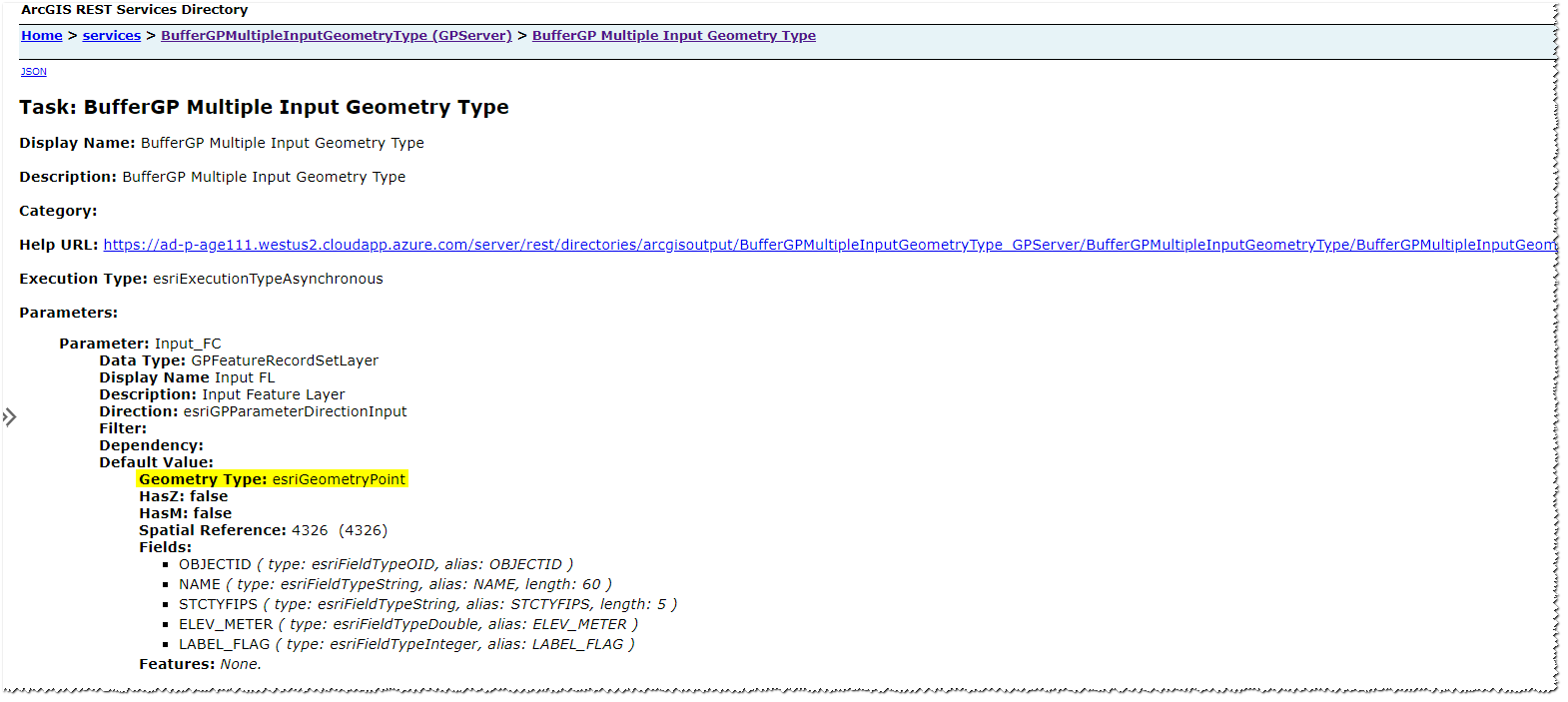

It works with ArcGIS Pro :
However, when I publish the result of the script (from ArcGIS pro) to a Web Tool (GP Service), the Geometry Type is always the same that the input geomtry used in ArcGIS Pro :
Therefore, in a WAB application, i can choose only a point feature layer as input :
I think it's not possible because "The geometry type comes from the input and output features that are used to create the result" | Source https://pro.arcgis.com/en/pro-app/latest/help/analysis/geoprocessing/share-analysis/web-tool-setting...

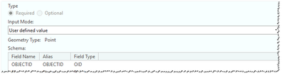

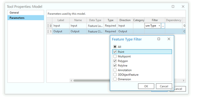

Hi @Bertrand_Laurancin , I believe it is possible.  Could you check these two things before publishing the web tool and verify if that works?
1st- The filter is set in script tool:
2nd while publishing, "Input Mode" for the tool is "User defined Value".

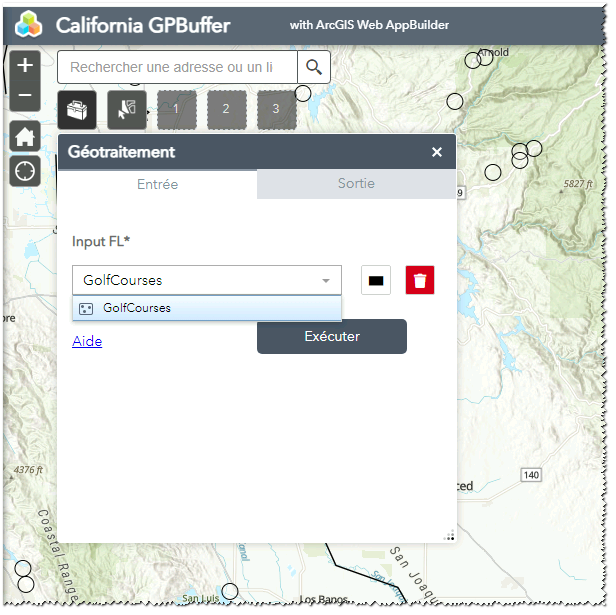

Bertrand_Laurancin
Hi @GeeteshSingh07,
You are right.

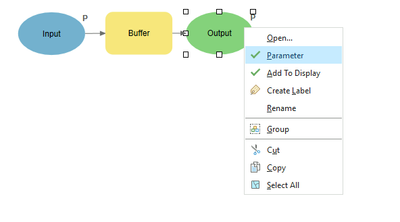

I created a model builder :
Bertrand_Laurancin_0-1709634757354.pngBertrand_Laurancin_0-1709634757354.pngBertrand_Laurancin_1-1709634796590.pngBertrand_Laurancin_1-1709634796590.png
It works in MapViewer :

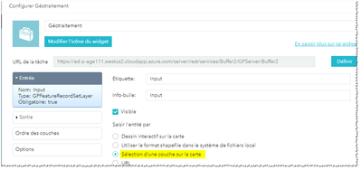

However, in WAB it still not able to run against a different geometry type compared to the original geometry used to create the tool in ArcGIS Pro :
I found about a bug :
BUG-000161045 : When adding a geoprocessing service as a widget to ArcGIS Web AppBuilder, the tool does not honor the same geometry types as the geoprocessing tool
Thank you for your help,
Bertrand

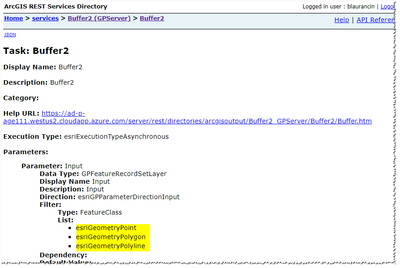

Bertrand_Laurancin
Hi @GeeteshSingh07,
I tried it :
import arcpy
arcpy.env.overwriteOutput = True
arcpy.addOutputsToMap = True
fcs_types = arcpy.GetParameterAsText(0)
fcs_list = fcs_types.split(";")
outputFcPt = r"C:\temp\output_buffer_pt.shp"
outputFcLine = r"C:\temp\output_buffer_polyline.shp"
outputFcPolygon = r"C:\temp\output_buffer_polygon.shp"
if __name__ == "__main__":
    for fc_type in fcs_list:
        arcpy.AddMessage("Processing: {}".format(fc_type))
        desc = arcpy.Describe(fc_type)
        shpType = desc.shapeType
        if(shpType == "Polygon"):
            arcpy.AddMessage("Shape Type :   " + desc.shapeType)
            arcpy.analysis.Buffer(fc_type, outputFcPolygon, "500 meters")
        elif(shpType == "Point"):
            arcpy.analysis.Buffer(fc_type, outputFcPt, "500 meters")
        elif(shpType == "Polyline"):
            arcpy.analysis.Buffer(fc_type, outputFcLine, "500 meters")

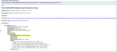

In the REST Description it is OK :
But in my WAB App i can select only a point layer as input (the same geometry type as the gp result used in ArcGIS Pro to publish the gp service) whereas the WebMap contains polygon and polyline layers :

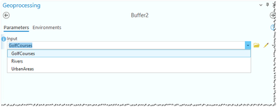

Bertrand_Laurancin

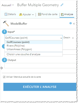

@GeeteshSingh07,
Yes in ArcGIS pro i can choose point, polyline or polygon layers from the gp service :
However, in the WAB i can select only a point layer as input (the same geometry type as the gp result used in ArcGIS Pro to publish the gp service) whereas the WebMap contains polygon and polyline layers :
Bertrand_Laurancin_1-1709566774717.pngBertrand_Laurancin_1-1709566774717.pngBertrand_Laurancin_2-1709566800826.pngBertrand_Laurancin_2-1709566800826.png
