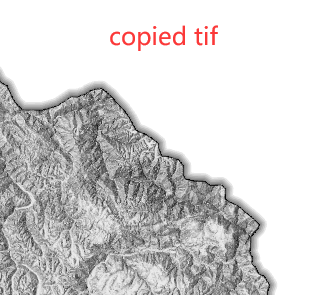

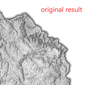

Thanks for your reply, I used the method you mentioned but I found some problems.
As the figure shown, you can see the value of original result and the copied tif is different, I don't know why.
The most important problem is, when I set a stable scale of layout, these two hillshade shown different version effect, the copied tif became darker in display compared to the original result, making the quality of my output significantly lower. I don't know what the reason is, and I can't adjust "Effects" and "Rendering" to make the copied tif look as good as the original result. And, I'm sure it's not a problem with my monitor.

The original image was stretched I suspect.  You would have to examine the statistics of the original to determine the min and max of the input

Right after I posted about the bug, I created a new MH, then I changed the Symbology from Stretch to Classify, so that ArcGIS Pro prompted me for a statistical calculation, after which I got a correct min and max value, then I restored Stretch. then I just copied this calculated MH and got a tif file that still had the problem I described in that post. The important thing is that this MH, which I have calculated, cannot be exported in the layout page! Whether it's JPEG, png or tif, all it exports is a blank page! This seems to prove that AFR files are not allowed to be modified.
I suggest you follow this procedure and check the results.
