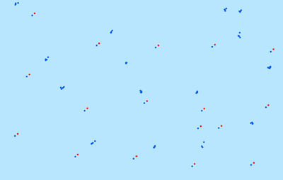

I am working with shapefiles which in part contain the same points but I assume due to reprojections in the past or possibly recalculations of geometries with different accuracies, those points drifted apart and i am now left with files that plot like this:
Is there any tools availible to identify and correct this drift so I can properly identify the matching points? Sadly the drift is not completely uniform across all points so simply moving all points by x/y is not an option.
Any ideas appreciated. Thanks a lot.

Maps-Berlin
Hey Johannes,
