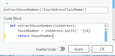

RIght click on your new field and select calculate, leaving the Expression Type as Python 3.
Define a new function in the code block window:
def extractHouseNumber(inAddress):
    houseNumber = inAddress.split(' ')[0]
    return houseNumber
And then enter the function name and pick your address field name as the function parameter:
That should just about do it....
