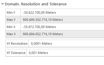

The coordinate system of the map is the same as the coordinate system of the feature class : Belge Lambert 1972 (WKID = 31370).
These are the values for resolution and tolerance
Thanks.
Scott_Harris
Thank you, @LStappaerts. Those look like reasonable values for resolution and tolerance.
