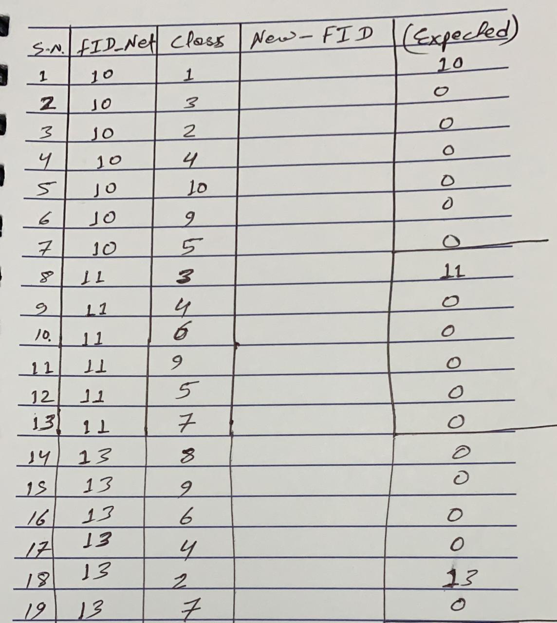

I have points shape file with multiple attribute fields, as below:
Attribute table sample
In above attribute:

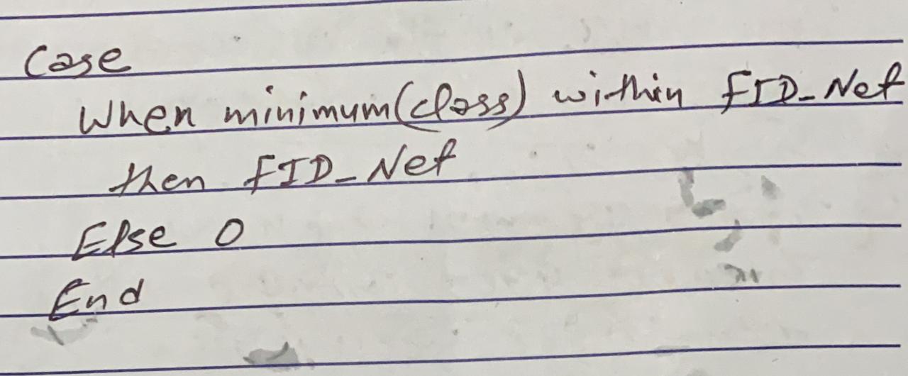

'FID_Net' is 'unique value/subset' and 'class' is the 'value'. And in my new data sheet, the values of column 'class' is not repeating. I have to copy that unique value 'FID_Net' to new field 'New_FID' of only one row which value 'class' is minimum within group 'FID_Net' and rest of others row should be 0 or NULL as in my paper's table (Expected).
rough sketch flow:

It does not account for only populating one row from each category
JimCousins
MVP Alum
There was not a mention of anything like this in your post, and this is a bit vague. Could you be more specific about your comment and just what it is you wish to do?
Jim
Kapil_DevAdhikari
@Jim Cousins, I have updated my question and simplified some conditions.
