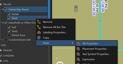

If that doesn't work, you're in for a lot of clicking, or possibly some Python. While you can copy a single label class's properties, you can't copy the class itself, so you need an existing label class to paste the properties into. Such a workflow would look like:
  1. Right-click label class in source layer and click "copy"
  2. Create a new label class in destination layer
  3. Right-click the new label class and click "paste", select "all properties"
  4. Groan inwardly and repeat for every single label class

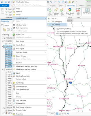

MichaelBillings
If you are still looking for an answer on this, XTools Pro for ArcPro will allow you to copy Label Properties to other layers in the TOC. It will copy multiple layer properties.  Also, make sure that your layer schemas are the same.
Hope this helps.
Michael

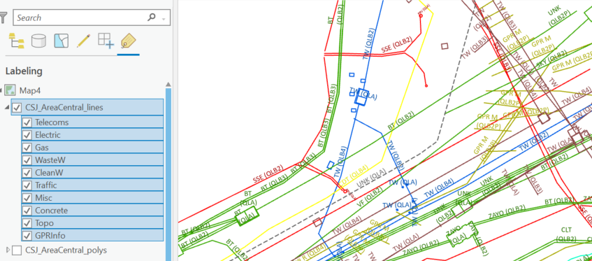

PatO_Brien1
Very handy as wanting to apply same labeling to 36 layers within Pro.
It worked well. However I note, the label Minimum Scale (Out Beyond) I had set on my Copy Labeling layer did not apply to any of the layers I pasted the Labeling to.
Nonetheless the tool saved me plenty of time by copying: My Label expression (generic to all layers) and text symbol.
