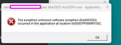

RTPL_AU
Honored Contributor
Just had a full crash after copying a field in the Attribute Table:

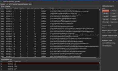

DavidLeggett
Yep.. Been experiencing the same thing.. Tried stopping teams and onedrive which can be clipboard hooks, but still experience the same thing with Pro. I have built a beefy PC i9, 64gbRAM (3200) and 4070 super - Pro diagnostic registers that the copy process completed in 14ms - But then goes unresponsive and hangs..
 Not sure if this might be a windows 11 thing? but having to restart project to fix copy/paste lags is not optimal.

Hi @ChrisUnderwood  – I've been experiencing significant copy/paste lag across all aspects of ArcGIS Pro. This includes copying feature layers, layout text and graphics, as well as label and attribute text.
As described by RTPL_AU, the issue appears minimal when first opening a project but progressively worsens with each copy/paste action, regardless of the type of content being copied. It eventually became so severe that I began running the Diagnostic Monitor to investigate, but the lag doesn't seem to discriminate by content type – it's consistent across all copy/paste operations within Pro.

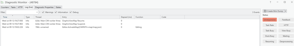

@ChrisUnderwood
I have not been able to see any correlation in the copy hiccups/freezes and anything in Diag Mon.
You will see the expected Suspend/Resume pair when copying.
No failures reported in the same period.
You know what's funny?
I opened DM to take this screenshot and lucky for me, Pro completely crashed when I Ctrl-C'd a layer in the Contents pane.
There isn't anything weird that I can video - just use Pro as you would when doing real work and expect that at any time when you copy anything using CTRL-C or Right-Click>Copy, Pro will throw a tanty.
Once it starts, it will get worse until you restart Pro.
