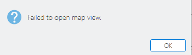

Thank you so much for the responses. I had successfully copied many layers before in Pro in an earlier version and this was the first time it gave me issues. This was right after upgrading to Pro 3.5.5. The aprx was created at an earlier version. @CodyPatterson you ended up being correct - it was in a corrupt state of some sort. I tried after the holiday break and this time the original map view wouldn't even open within the aprx.
So I'm recreating the map view and it's working fine. So we'll blame this on some mysterious corruption.
