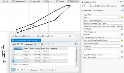

It works, but I am on Beta 3.2, so if there was a bug, then it has been fixed. I find no bug report on the support site.
So have a look at the inputs that I used for the tool to compare. I used an new empty map and sent the result to a file gdb.
Good luck... also there is polygon overlap in 1, 2, 3 which I assume you know.
