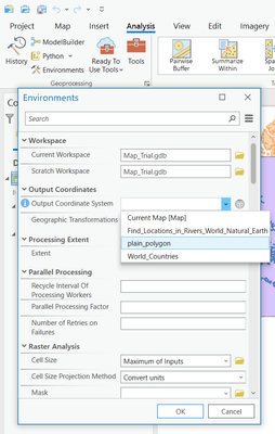

Hi @LanceCole,
There are some checks are needed to unify the coordinate system for all the layers and outputs
1- Maybe your layers have a different coordinate system than the map itself, so please check the coordinate system for the map and the layers to be edited.
2- Simply, you could define the desired coordinate system "Output Coordinate System" from environment settings from the analysis tab as in the image below 👇
Please try these checks and let me know the results.

LanceCole
MVP Alum
@Hala_Ghareeb ,
Thanks for the input.  I have not had a chance to try your possible solution was we are under a deadline to get this out today.

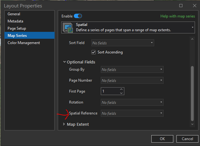

Lance, what version of Pro are you running? I do editing in my map series in pro quite a bit and have not had the issue of the coordinate system changing on me. One thing I have to make sure of is that I am "clicked" in the right map on my layout. Sometimes I'll accidentally click on my "inset" map which is usually in web mercator, so I'll have to remember to click on my main map (clicking it makes it the active map). Also, in the map series properties, do you have a Spatial Reference field defined?
This could be causing issues too.

AlexHirth
Thanks. I too set Spatial Reference instead of Extent to a field at the end of a sick day here and could not figure out what I did wrong. Easy to fix, but endlessly frustrating mistake.

@AdrianWelsh ,
We are running ArcGIS Pro 3.0.3.
We currently do not have a spatial reference field included in our dataset for this map series.  I assume this would be a WKID value?  All of the data and maps are in the same coordinate system and everything works fine as long as you do not edit the Index Layer data while the map series is enabled.  When you do, the map coordinate system will randomly change to an unrelated coordinate system.

AdrianWelsh
MVP Honored Contributor
Thanks for the feedback. I really have not tried using the Spatial Reference selector so I am not sure if it's a WKID or some sort of projection string. One question, how do you know that the coordinate system is changing on you and when does it change? Are all your layers in the same coordinate system for this particular map?
