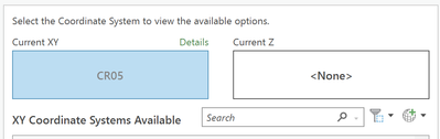

Hello! Thanks in advance if you're reading this.
I've been trying to change the coordinate system from WGS84 to CR05. Despite my efforts changing the coordinate system in Map properties and changing it in Project options, the same coordinates show up at the bottom of the screen. What it's interesting is that no matter what coordinate system I chose, the default units never change. No matter what I chose, the software always displays WGS84 coordinates and I don't understand why. I've been trying to add points from a table which have CR05 coordinates and I always get and error. If I insert the same point using WGS84, I never get the error.

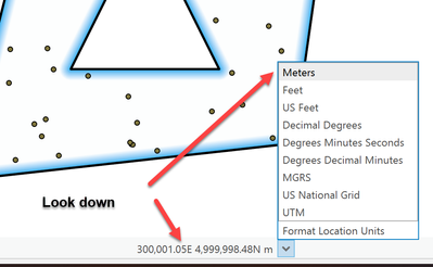

bottom of the map?

IsaacDelgado
Hi Dan! Thanks for the help. I can change to meters using WGS84, that's not the case with CR05. However, if I change to meters it still won't change the coordinates. My table has points with coordinates 361073.539,1155851.15 which don't really math at all with WGS84.
DanPatterson
MVP Esteemed Contributor
your "table" I hope represents a featureclass in a geodatabase and you defined its coordinate system.  If the coordinate system of the layer isn't defined and the map doesn't have its coordinate system defined as such, then you won't see meters (or whatever you need).  If you defined it as a geographic coordinate system with a WGS84 datum, then you defined it wrong and need to fix it and define is appropriately.  Then you can see the units you want
