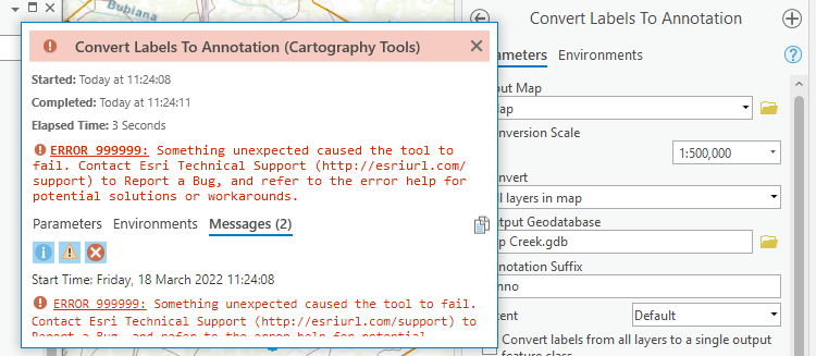

Greetings, i had been trying to convert my labels to annotation I am trying to mask my layers, however Im encountering an error in almost all of my projects except one. Please see the attached error I'm an encountering and assistDatABSE.PNG

I see you have a space in your output geodatabase path. In general, it's a big no-no to have spaces or special characters in any paths you'll be using in ArcGIS. Try running it again but replace the space with an underscore or similar.

Is your data versioned by chance?  If so, there is BUG-000120623 - Failed to run the Convert Labels to Annotation tool on versioned data in ArcGIS Pro when a feature-linked annotation is selected.  One solution is to unregister as versioned, run the tool to create the annotation, re-register as versioned.

Im not sure. Tried to create a new geodatabse but I'm still encountering the same bug.
