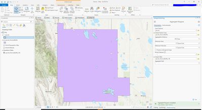

Aha - sorry I misinterpreted your question but it's the first step to create the larger, single parcel polygon feature class.  To create the single polygon boundary, I then used the Aggregate Polygons GP to create the single boundary polygon from all the parcels.  I used an aggregation distance of 500 feet - seemed to work mostly - could tweak parameter values appropriate for your need.  See images below.

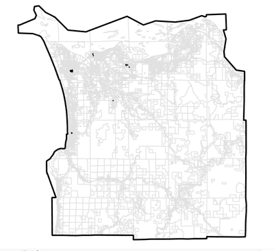

Use Merge to get one feature class. Then use Dissolve. Leave "Dissolve Fields" blank. There will probably be holes. Edit by selecting and deleting them.
Here is my county, grey lines are taxlots and black line is the dissolve output.
