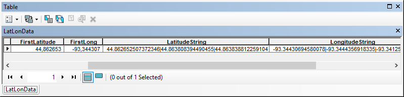

To show you a snippet of Python code to translate the lat and lon strings into a polyline, see the example below. I converted the data that you posted into a table in a fgdb to allow easy manipulation:

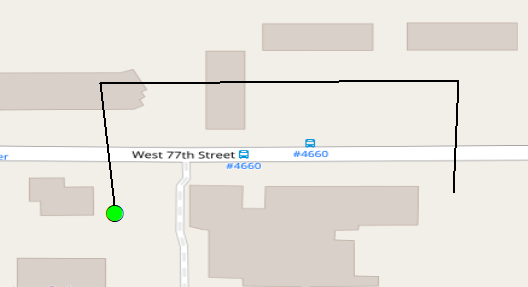

... and converted the strings into a line:
